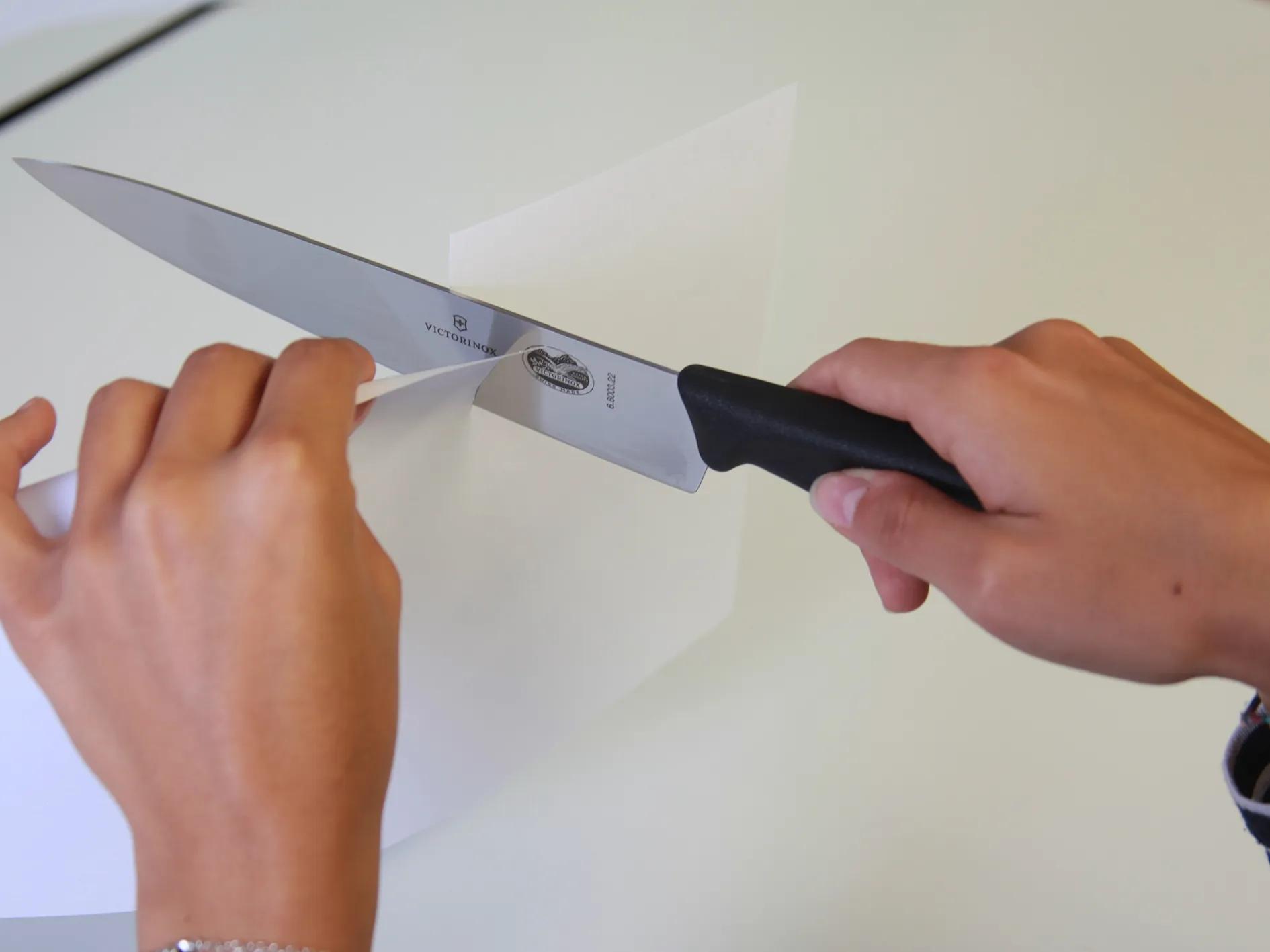

Two simple tests can tell you. Try slicing through a sheet of paper, if it tears or snags, your knife is dull. Or slice a tomato. A sharp knife should glide through with no resistance; if it struggles, it’s time to sharpen.

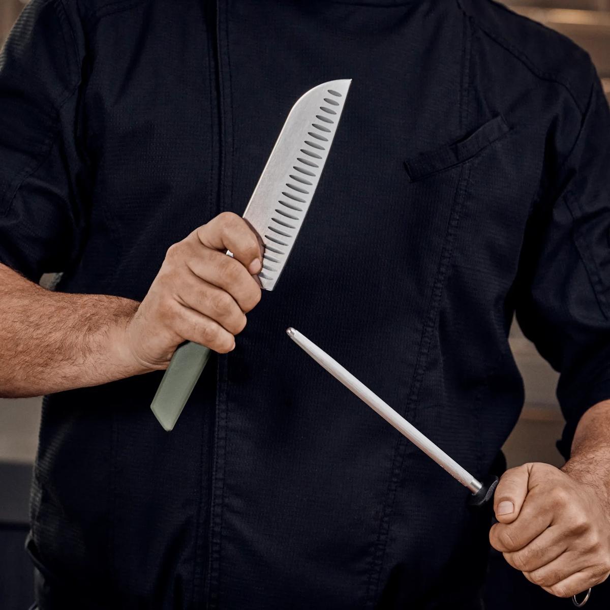

Next, use a honing steel to align the freshly sharpened edge. If you are not experienced at using a honing steel, it’s best to place the tip on a folded tea towel or damp dish cloth for extra stability. Experienced users will be accustomed to holding the steel in mid-air.
Hold the knife at a 20° angle to the honing steel.
Pull the blade down and toward you, from heel to tip.
Repeat this motion five times on each side.

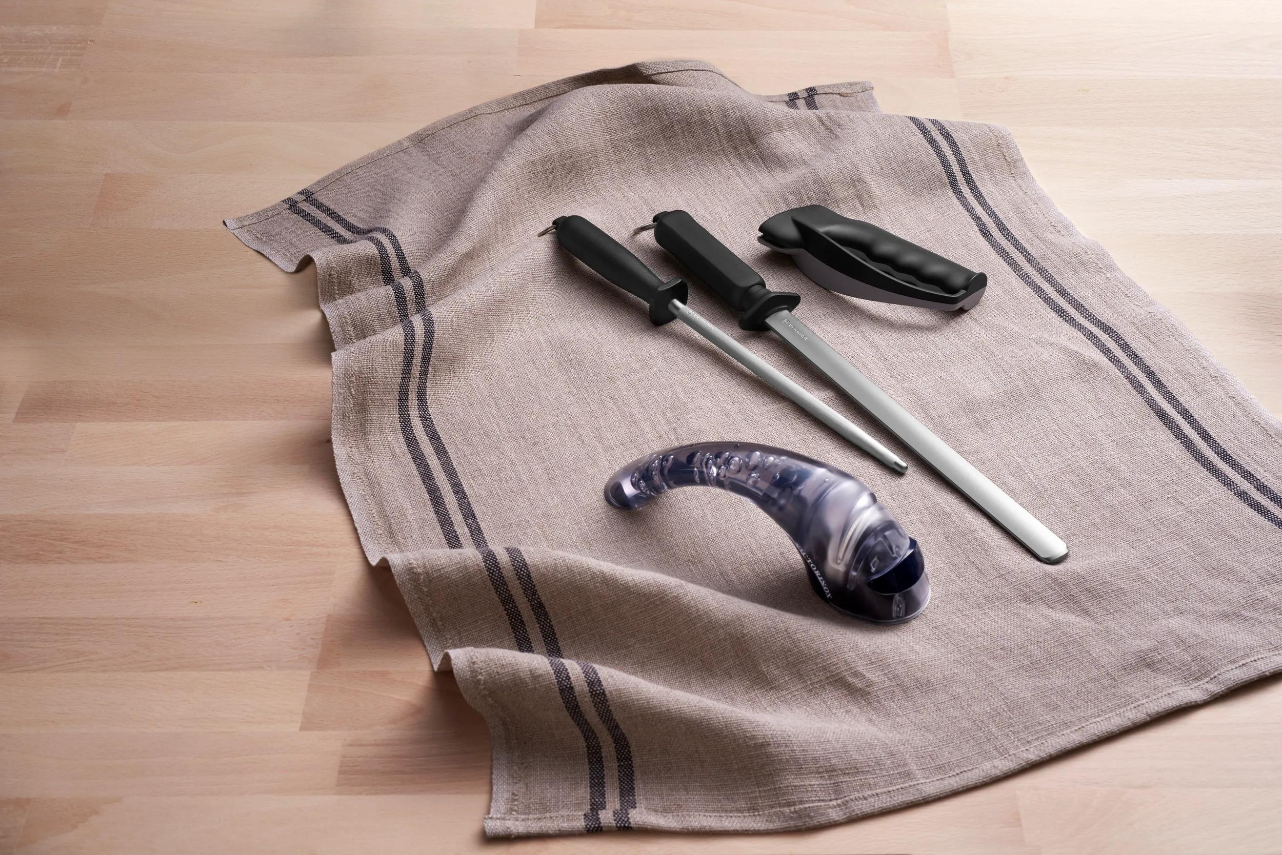

We offer a range of sharpening and honing tools, but which one’s right for you? It starts with knowing the difference: honing realigns your knife’s edge, while sharpening creates a new one.
Stamped knives are made of softer steel and are easy to hone with a standard honing steel. Forged knives have a higher hardness and need a diamond, tungsten carbide or ceramic honing steel for best results.
For quick touch-ups on smaller kitchen knives, our Sharpy tool is a great pick. Larger wavy blades like bread knives should be professionally sharpened. But if you're experienced, the Sharpy tool can handle small wavy edges too. For most people, we recommend a professional service for all wavy blades.
